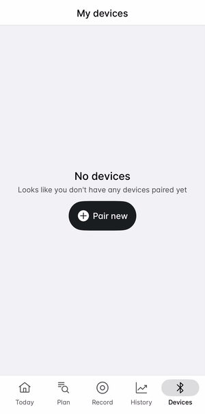

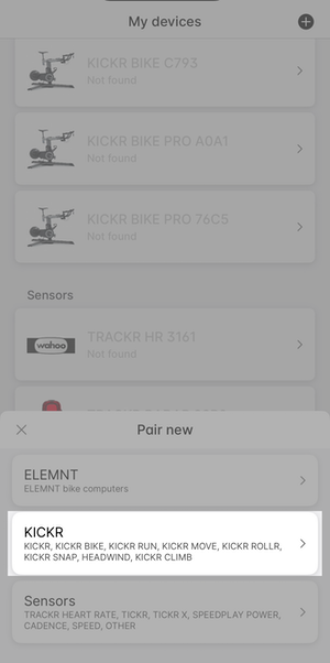

Pairing to the WAHOO app
- Open the Wahoo app.
- Navigate to the Devices tab.

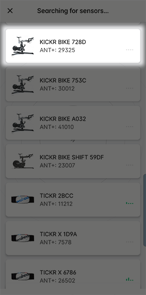

- Select Pair new (or the + sign if another sensor is paired).
- Select KICKR from the pop-up menu.
- The Wahoo app will then proceed to search for available KICKRs
- Select the correct KICKR
- Your KICKR BIKE is now paired
- For a guide to set up the WAHOO app see the WAHOO app overview
- For additional information regarding the pairing process, please visit Pair a KICKR BIKE to the Wahoo app

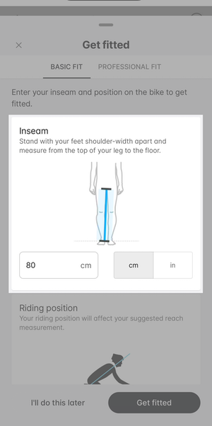

The WAHOO app will help you get an exact fit on your KICKR BIKE. The in-app fit calculation walks you through recreating your outdoor bike fit indoors using the Fit Wizard with basic and professional fit options
- Once you have completed the assembly and setup of your KICKR BIKE, you will be prompted to create bike fit
- Here, you will be given the option for a Basic FIT or a Professional FIT
- You can either choose to do this now or later, depending on your preference

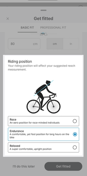

- For a Basic FIT, you can input your inseam and choose your preferred riding position
- From here, the Wahoo App will create a Basic FIT and the measurements to adjust your KICKR BIKE to.

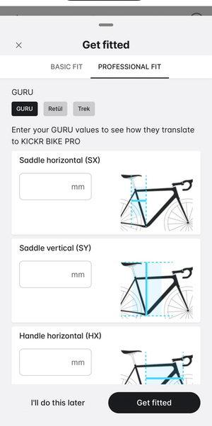

- If you wish to input measurements from a personal bike FIT, you can do this under the Professional bike FIT options.
- Here you can choose to input measurements from a GURU, Retül, or. Trek bike FIT. The Wahoo App will generate the measurements to adjust your KICKR BIKE to.
- See the Fit and Adjustment [KICKR BIKE] support article for the full steps

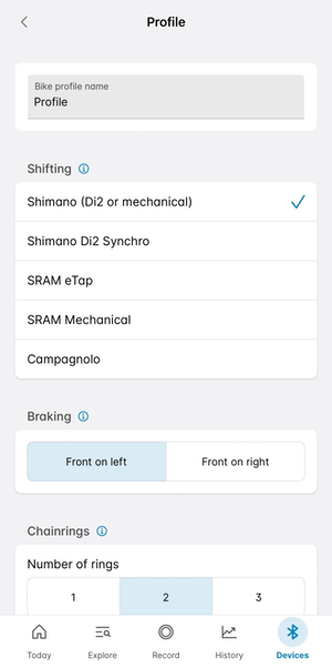

The WAHOO app allows you to choose your drivetrain option! Available drop bar shifter options are Shimano, SRAM, and Campagnolo.
- Once you have set up your KICKR BIKE FIT, you can then set up your preferred shifter profile

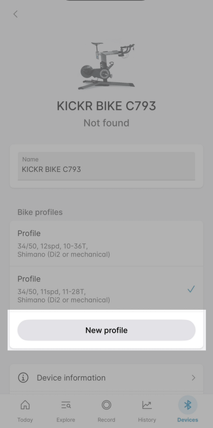

- With or without the KCIKR BIKE connected to the Wahoo App, select your KICKR BIKE from the devices menu.

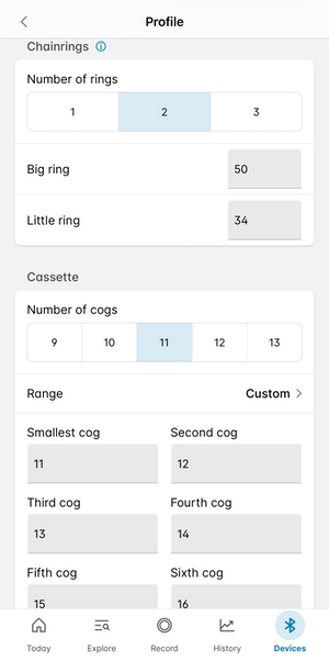

- Here, you should be able to select New profile under the Bike profiles menu.
- Within this menu, you can customize your type of shifting group set, number of chainrings, and other gearing options to match your riding style and preference.
