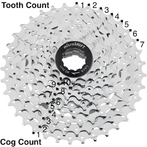

- cassette cog count (how many cogs/gears are on the cassette),
- cassette min/max tooth count (how many teeth on the smallest and largest cogs), and
