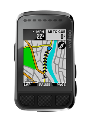

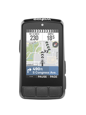

ROAM 2*
  • Greater than 3 inches / 8 cm long
  • Slightly wider at the bottom than the top
  • Top and left side LEDs
  • 3x convex front buttons
  • Color screen

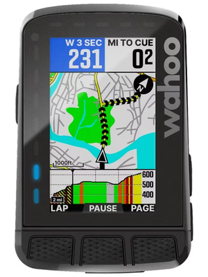

ROAM 1*
  • 3x concave front buttons
  • Color screen

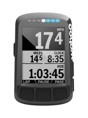

BOLT 2*
  • Less than 3 inches / 8 cm long
  • Top LEDs only
  • Color screen

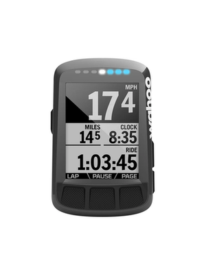

BOLT 1*
  • Top LEDs only
  • Black and white screen

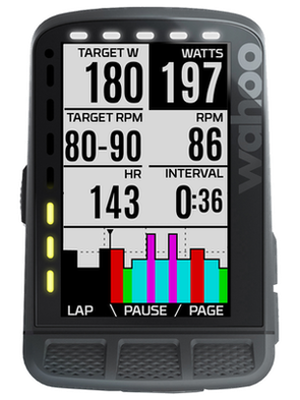

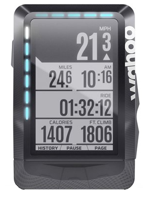

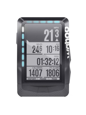

ELEMNT*
  • Clearly squared corners
  • 3x convex buttons

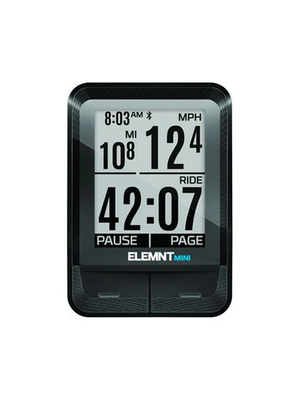

MINI*
  • Less than 2.5 inches / 6 cm long
  • No LEDs
  • 2x convex front buttons
