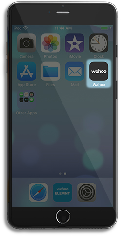

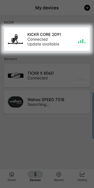

  2. Open the Wahoo app.

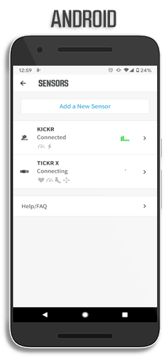

  3. Navigate to the Devices tab.

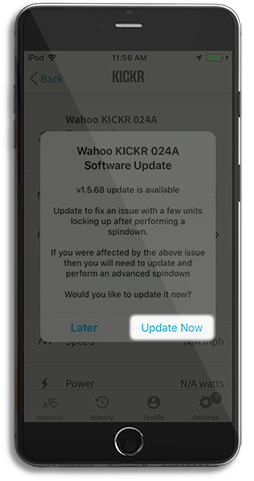

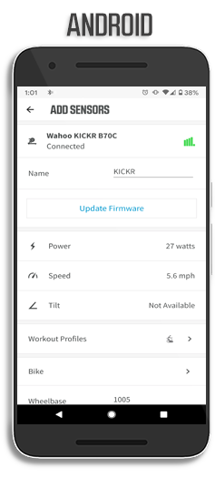

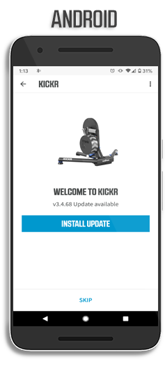

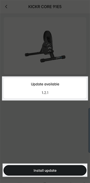

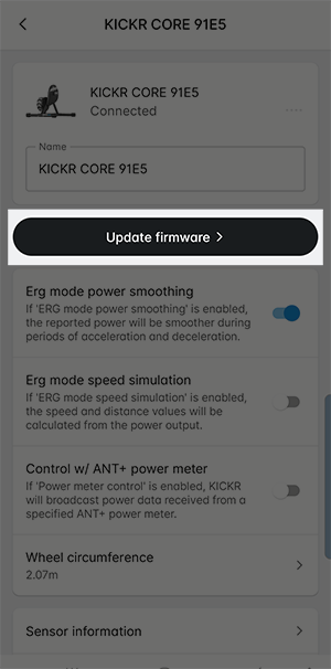

  4. Select your trainer or add it if you have yet to pair your trainer.  Upon establishing a connection with your KICKR, the Wahoo  app will determine if your trainer's firmware is out of date. If an update is available, the app will display a notice - Update Available
  5. Select Update firmware.
    wad-home-devicesselected-300.png wad-mydevices-coreselected-300.png CORE-sensordetails-selection-updatefirmware-crop-sm.png

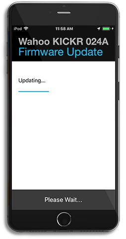

  6. The app will list the firmware version update available. Select Install update and leave your device near the KICKR until the update is complete.
    CORE-installfirmware-selection-crop-sm.png blanktrans300x600.png blanktrans300x600.png

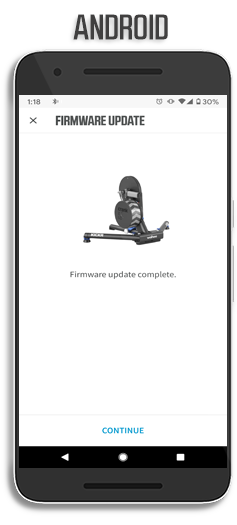

  7. Once the update is finished, complete the following:
    1. Reset your trainer by unplugging it for 30 seconds, and then plugging it back in.
    2. Turn Bluetooth off and back on in phone/tablet system settings to reset the connection.
