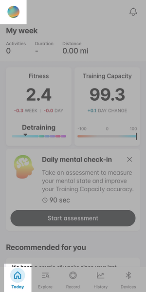

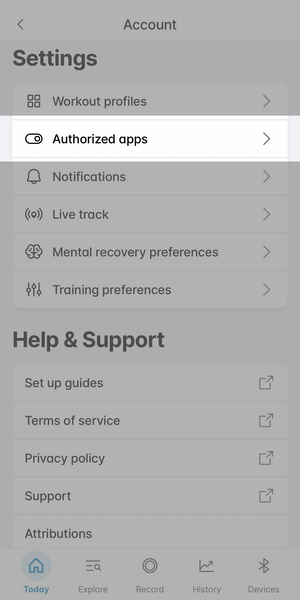

  1. On the Today tab, select the Profile icon in the upper left corner.

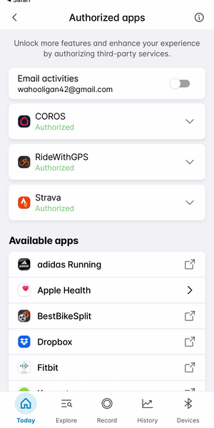

  2. On the Account page, select Authorized Apps.
  3. Select the app you wish to authorize from the list of Available apps
  4. Enter your credentials / authorize the app.

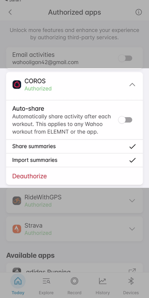

Auto-sharing
In order to enable auto-sharing,
  1. Authorize the app as described above.

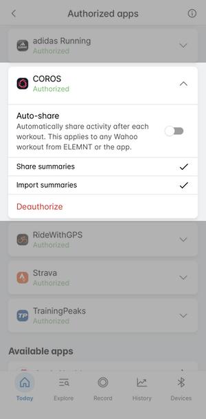

  2. Expand the downward facing arrow next to the app name.
  3. Toggle Auto-share On.

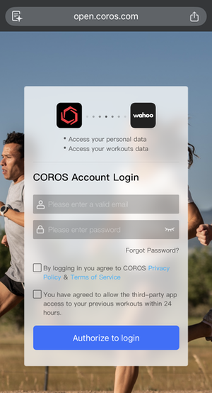

Authorize in the partner app / web interface
Other, mostly more newly connected apps / services are connected through the Wahoo Cloud API. To connect these apps / services to your Wahoo account, authorize your Wahoo account in the partner's app or web interface, using the email and password used to log in to the Wahoo app.
Because the authorization process will differ between app partners, we suggest reviewing the app partner's interface, support documentation, and consulting their support team for how best to connect your Wahoo account.
See Wahoo App Partners for a list of app partners with links to their respective sites for information on how to make this connection.

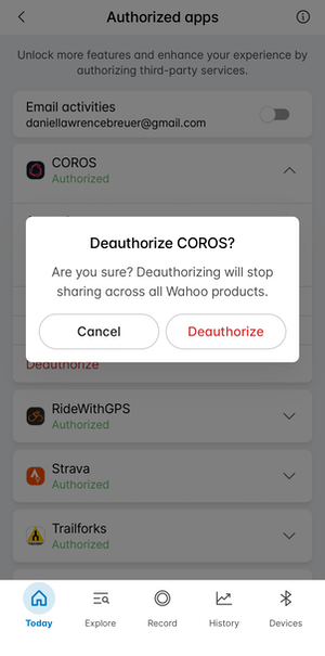

Deauthorize / Reauthorize an app
If a workout is not automatically sharing to a 3rd party app that you have authorized and will not if you attempt to manually re-share, the first step to resolving this should be to deauthorize and reauthorize the app to reset the connection between Wahoo and the app.
For apps authorized in the Wahoo app
Navigate to the app, select the down arrow to the right to expand the section, and then select Deauthorize

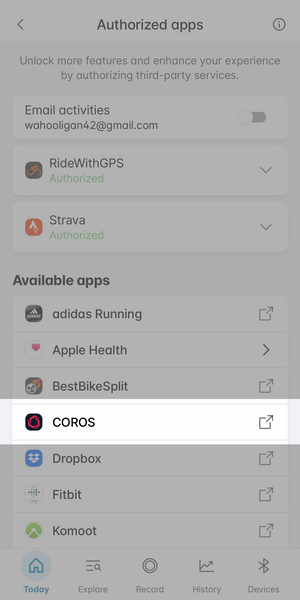

The app should return to the Available apps list, where you can select it and reauthorize it.
