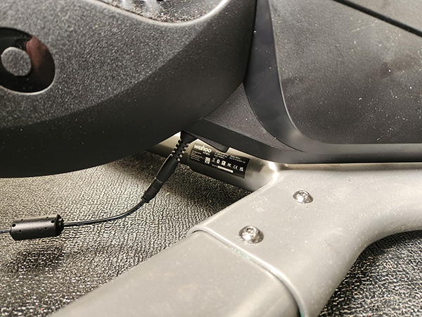

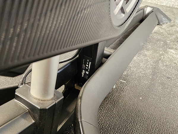

KICKR models can be identified by the Part number on the white sticker on either [1] for KICKR BIKEs, the back side of the center mast, below the crank, or [2] BIKE SHIFT, the inside of the left rear leg, most easily seen from the right.
Model Part number
BIKE v2 (2022) WFBIKE3
BIKE v1 (2019) WFBIKE1
BIKE SHIFT (2023) WFBIKE2
KICKR BIKE part number sticker on the back of the center mast, below the crank KICKR BIKE SHIFT part number sticker on the inside of the left rear leg, next to the power cable

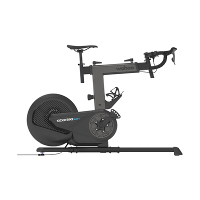

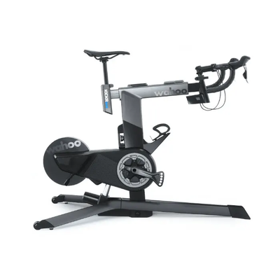

If the sticker is obscured or missing, you can visually identify a KICKR BIKE from a KICKR BIKE SHIFT, and the version of a KICKR BIKE using the following distinguishing features.
KICKR BIKE v1/v2 side profile with an exposed metal flywheel and angular frame KICKR BIKE SHIFT side profile with a fully covered flywheel and KICKR BIKE SHIFT label
BIKE v1/v2 BIKE SHIFT

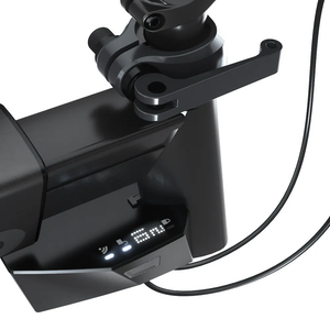

KICKR BIKE v1/v2 handlebar control unit (HCU) below the stem, with its lit gear display and cables KICKR BIKE v2 rear leg with the power dongle location highlighted under the flywheel cover KICKR BIKE v1 rear leg with the power dongle location highlighted under the flywheel cover
BIKE v1/v2 HCU BIKE v2 power dongle BIKE v1 power dongle
BIKE v2
  • Smaller diameter exposed metal flywheel
  • Digital head control unit (HCU) below the where the stem assembly meets the frame
  • Dual port in the power dongle to the right of the flywheel.
BIKE v1
  • Single port in the power dongle to the right of the flywheel.
BIKE SHIFT
  • Larger diameter fully enclosed flywheel/brake assembly
  • No head control unit (HCU) below the where the stem assembly meets the frame
