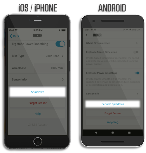

  3. After tapping on your Wahoo trainer, the Trainer Setup Page is displayed. Wait a moment until your trainer is fully connected, then scroll to the bottom of this page to tap the Spindown button (or the Perform Spindown button on Android).
    Note: a Bluetooth connection is required
