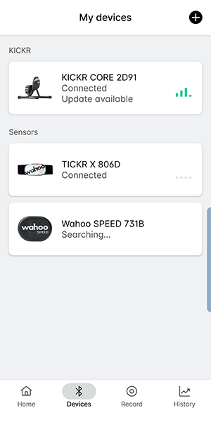

When a sensor is paired, the app will check the sensor's firmware against the firmware server for the current version. If the sensor's firmware is not current, Update available will appear under the sensor name in the Devices tab.
  1. Navigate to the Devices tab.

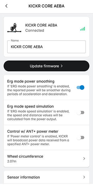

  5. Select Update Firmware and follow directions to update the sensor firmware.
  6. Once the update is finished, you're prompted to toggle Bluetooth off and back on in the iOS or Android Settings app to refresh the connection. We also recommend you power cycle or restart your sensor by unplugging them for 30 seconds after an update (if the device can be powered off. You do not need to remove batteries from sensors).

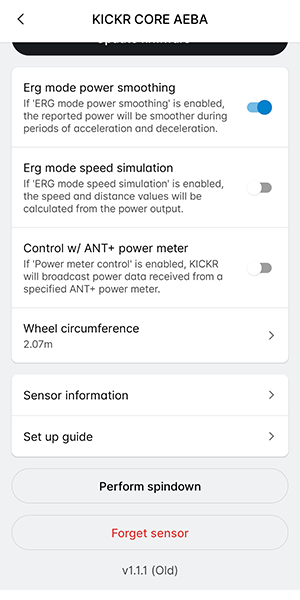

Wahoo app My devices screen showing KICKR CORE connected with Update available Wahoo app KICKR CORE device screen with the Update firmware button Wahoo app KICKR CORE device settings with the installed firmware version shown at the bottom

You can always check the currently installed firmware version by scrolling to the bottom of the sensor details page where the version number and its status -- (Old or Latest) will be listed.
