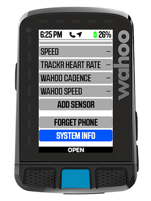

  1. The computer should warm up to the Ready to Ride screen, with Start Ride highlighted at the top. If it doesn't, tap the button on the left side of the computer to access the Ready to Ride/Menu screen.
  2. Tap the upper button on the right side of the computer once to cycle up to the bottom of that screen. System Info should now be highlighted.

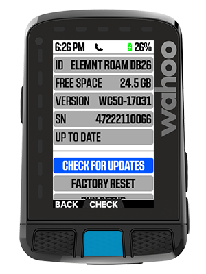

  3. Tap the middle button to select Open. You should now see ID, Free Space, Version, and SN, and Check For Updates should now be highlighted.
  4. Confirm that you have at least 250MB of Free Space.
    • This generally is only a question with the first generation ELEMNT, BOLT, or ROAM.  The computer needs at least 250MB of space to download the new firmware version to memory before loading it.  If you have less than 250MB (and sometimes a little more), you should create a little more space by temporarily deleting some map regions that you don't plan to ride in soon. Details on how to do that are described in the Add, update, or delete Maps on an [ELEMNT] article.  Note that there's no risk of loss here, as you can always re-download those maps for free using the process described in that article.
    • If you have 250MB, keep reading.
  5. Tap the middle button to select Check.
