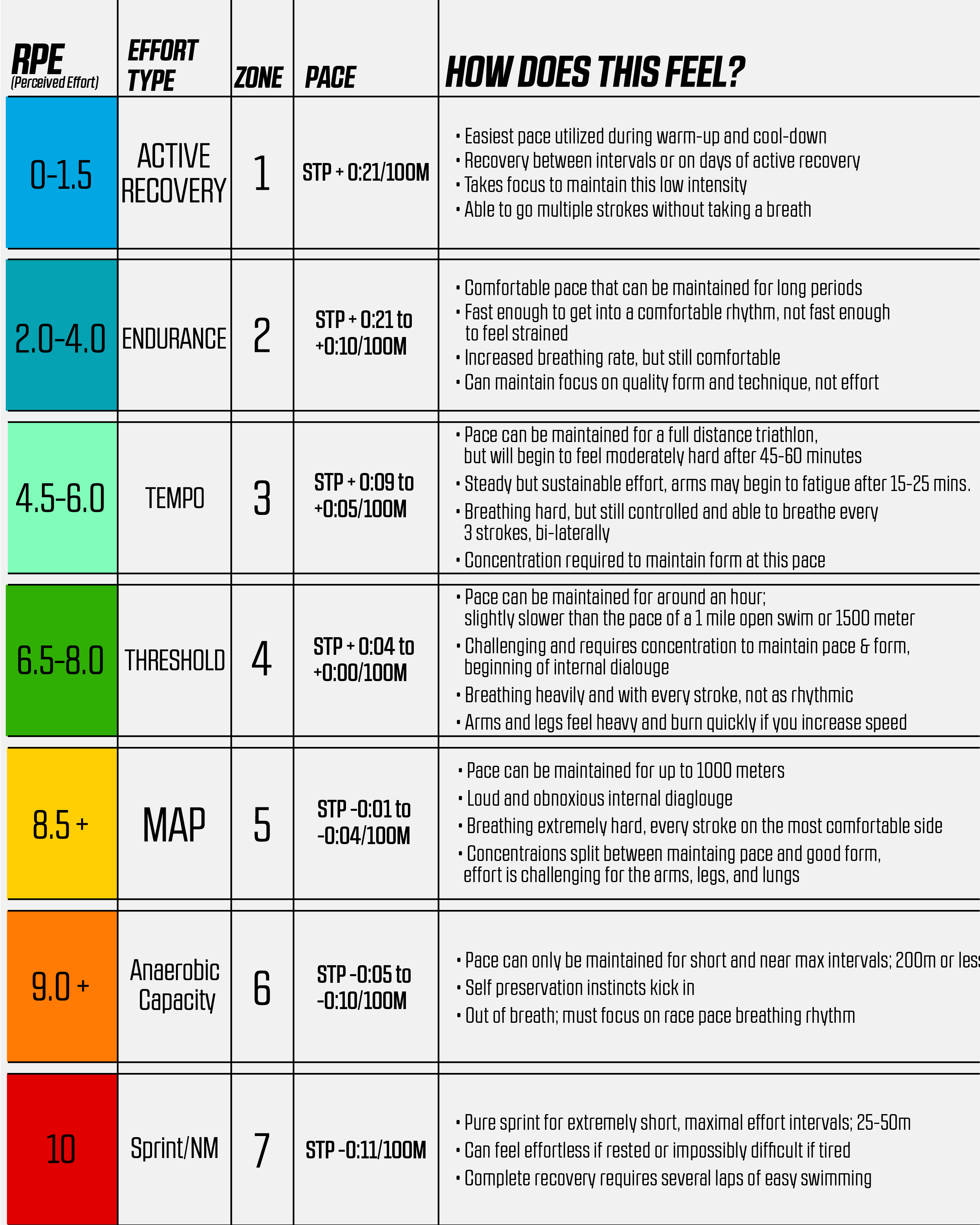

Target Pace (expressed as a % of your Swim Threshold Pace )
sTP is based on the pace you could theoretically maintain for 1000m of continuous effort. We do not provide heart rate zones for swimming because it simply isn't practical, so your training zones are based on pace or velocity per 100m. After completing the 50/500m swim test, you'll be able to calculate your pace zones for training in the same seven zones as running and cycling; i.e. active recovery, endurance, tempo, threshold, MAP, anaerobic capacity, and sprint/NM.
