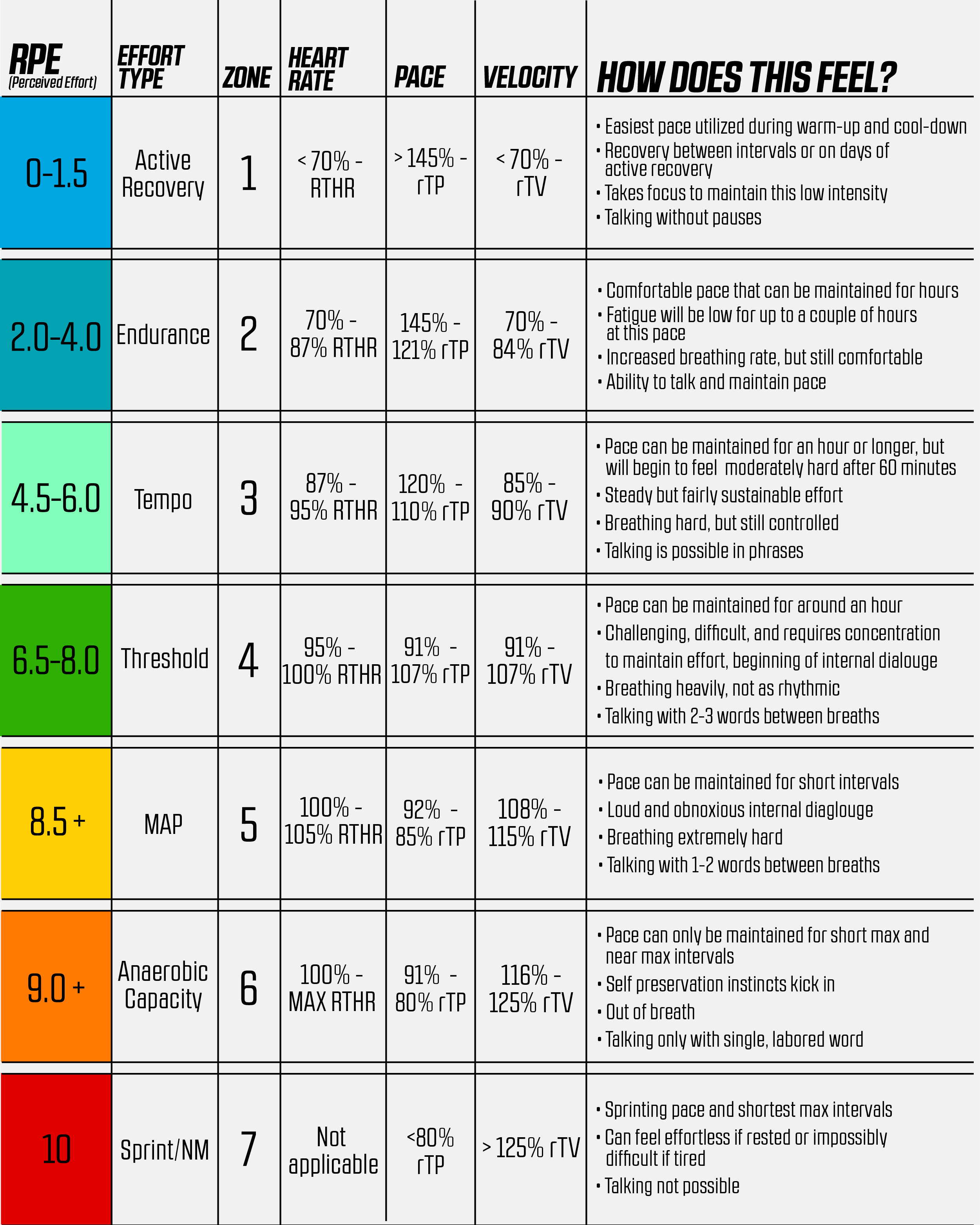

Duration and Intensity
Each section of the workout is divided into a number of segments of specific duration and intensity. The description of each workout “segment” will include the following information:
Duration- The length of time you'll spend in each interval.
Target RPE- The recommended Perceived exertion, or how hard you FEEL like you're working.
Target Pace (expressed as a % of your Running Threshold Pace )
rTP - This is roughly the pace you could hold for a 10K of continuous running. The thing to remember when basing efforts off of rTP is that a higher percentage of pace, such as 120%, is a slower speed and easier pace than 100% rTP, and 90% of rTP is a faster speed and harder pace thanrTP; so a tempo run would be completed at 110-120% of RTP, while a tempo effort on the bike would be completed at 75-90% of FTP
Target Heart Rate (expressed as a % of your LTHR as determined by your 5k pace test).
RTHR- the average heart rate you would have while holding a steady training effort for an hour.
For example, most runs will begin with a warmup of 10-minutes at an easy effort. So it would have an RPE of 2, target pace of 145% of your RTP, and target Heart Rate that is less than 70% of your RTHR and would be written as:
10 minutes @ RPE 2 -- 145% of RTP --HR < 70%
