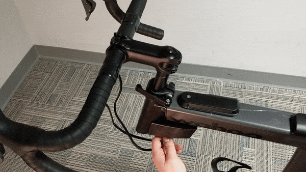

  5. Remove the plug under the setback adjustment. While this can often be done by just pulling, a flat head screwdriver or similar may be needed to pry.
  6. Cut any zip ties holding the wires together or to the plug. Be careful to avoid cutting the wires or letting them fall back into the unit. We advise placing a screwdriver, pen, or even a finger between the two wires as a further precaution against this.
  7. Separate the wires at their connection from the wider end by pressing on the tab near the wires. Do not try to separate these wires at the narrower end - see the image below for details.
  8. Push the lower wire back into the unit to ensure it does not catch when removed.
