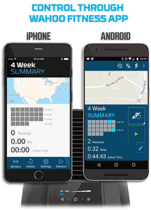

  1. With the KICKR HEADWIND plugged in and Bluetooth® enabled on your mobile device, open the Wahoo Fitness app and tap Sensors.
    On Android, be sure to also enable location services.
  2. Select Add New Sensor to search for available sensors.
  3. Choose HEADWIND from the list.
  4. Always Upgrade Firmware if available and follow the directions in the app for the newest features and best experience.
  5. Once updated, select Save device to add it to the saved sensors list.
  6. Mark the workout profiles KICKR HEADWIND will be active for (Indoor Cycling, Treadmill, etc.) and select Done to complete pairing.
  7. With HEADWIND listed under saved sensors, return to the main menu.
  8. To control airflow, start a workout in a profile marked active when saved (Indoor Cycling, Treadmill, etc.) to find the fan icon appear whenever the KICKR HEADWIND is paired.
  9. Open the KICKR HEADWIND control menu by tapping the fan icon.
  10. With Control highlighted, manually adjust intensity using the slider. Switch to Speed or HR for control from a trainer or sensor that's been directly paired to KICKR HEADWIND following these instructions.*
    *KICKR HEADWIND must be directly paired to a sensor to receive speed or heart rate data.
