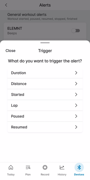

Triggers
A custom alert with your preferred information value can be triggered by any of the following status changes:
  • Workout Start
    • When the workout is started, played only once.
  • Workout Pause
    • Whenever the workout is paused, either according to auto-pause or manually selecting the Pause button in workout.
  • Workout Resume
    • Whenever  the workout is resumed, either from auto-pause or manually selecting the Resume button in workout.
  • Lap
    • Whenever a lap is recorded, either according to preset auto-lap settings or manually selecting the Lap button in workout.
  • Duration (active time)
    • At a fixed repeating interval of active time, set to the nearest second.
  • Distance (active distance)
    • At a fixed, repeating interval of active distance, set the to the nearest hundredth of your chosen distance unit (mile or kilometer).

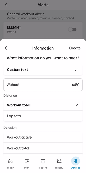

Information categories / value labels
You can choose any single information value (or multiple values) to be played at a given trigger. The
  • Example: Present lap average pace and lap average heart rate when triggered by 1 mile auto-lap intervals.
When an information value is presented, it will be presented as information label + information category + information value
  • Example: Lap average heart rate 147
If a information value does not have a fixed unit (i.e. distance could be miles or kilometers), the unit will also be played.
  • Example: Lap total distance 3.2 miles
Available Information Categories/Values
  • Custom text
    • 0-50 characters of your choice
  • Distance
    • Workout total
    • Lap total
  • Duration
    • Workout active
    • Workout total (includes paused time)
    • Lap active
  • Calories
    • Workout total
  • Speed / pace
    • Current
    • Workout average
    • Lap average
  • Heart rate
    • Current
    • Workout average
    • Lap average
    • Current zone
  • Power
    • Current
    • Workout average
    • Workout normalized
    • Lap average
    • Lap normalized
  • Cadence (Cycling) / Stride Rate (Running)
    • Current
    • Workout average
    • Lap average

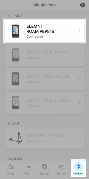

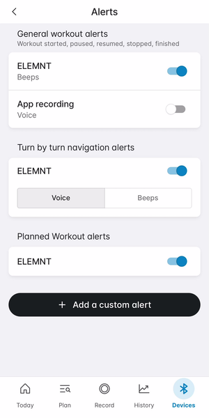

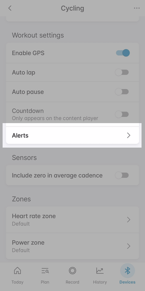

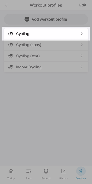

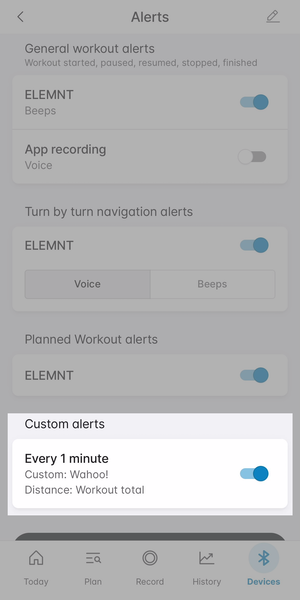

Set up a custom alert
  1. Navigate to Wahoo app > Devices > computer name > Workout Profiles > workout profile name > Alerts
  2. Select Add a custom alert.
wa-devices-r3selected-300.png wa-r3-devices-roam-workoutprofilesselected-300.png wa-devices-r3-workoutprofiles-cyclingselected-300.png

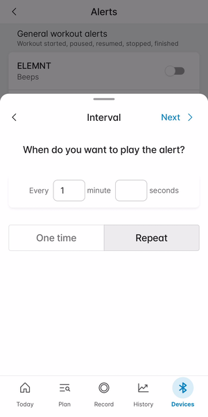

  1. Select your trigger.
  2. Select your interval and One time or Repeat
  3. Select your desired custom text or information value.
  4. Select Create.
wa-r3-customalerts-trigger-300.png wa-r3-customalerts-interval-300.png wa-r3-customalerts-information-300.png

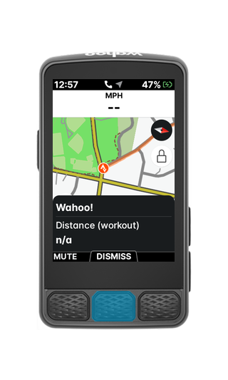

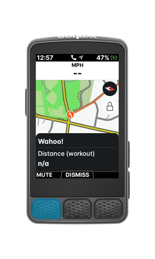

Use alerts
Once a custom alert has been set up for a workout profile and a ride has been started on that workout profile, alerts will appear as defined by the triggers and intervals that have been set up.
When an alert appears, it will remain until manually dismissed by using the Dismiss button. This will dismiss the current alert event. If a recurring alert has been set up, it will reappear when the next trigger condition is met.

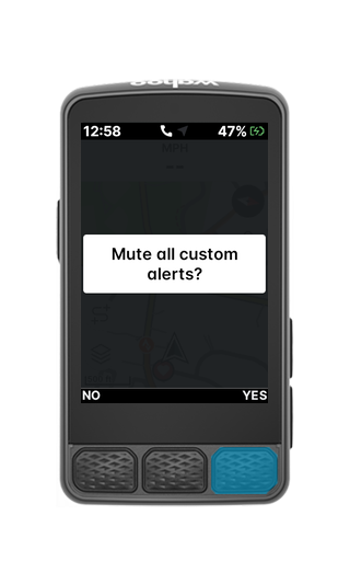

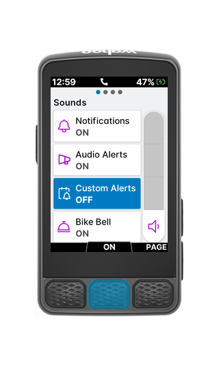

To mute (temporarily disable) custom alerts for the remainder of that ride, you can select the Mute button. You can undo the muting by navigating on the computer to the Device Settings page and select Custom Alerts under Sounds.
Note: You cannot mute individual custom alerts. Muting custom alerts for the remainder of a ride will mute all custom alerts for that ride.
r3-customalert-mute-r320.png r3-customalerts-muteconfirm-r320.png r3-customalerts-unmute-r320.png

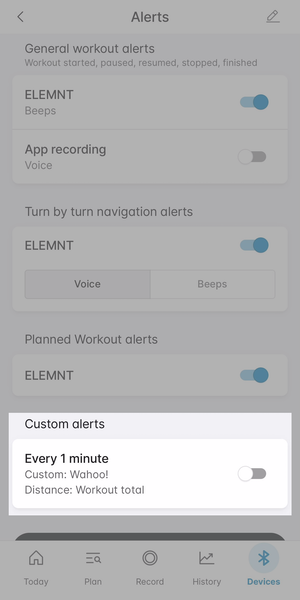

Disable an existing alert
  1. Within the Alerts submenu, select the toggle to the right of the alert you wish to disable.
wa-r3-alerts-enabled-300.png wa-r3-customalerts-disabled-300.png blank300x10.png

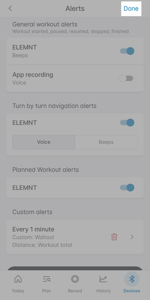

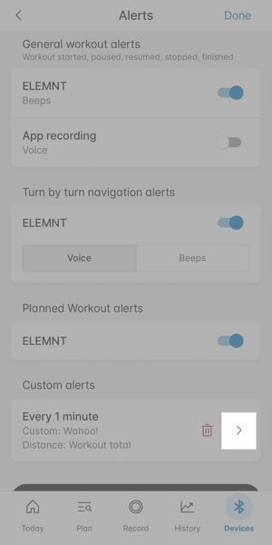

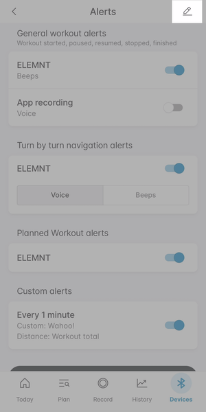

Edit an existing alert
  1. Within the Alerts submenu, select the editicon.png  [Edit] button.
  2. Select the right facing arrow to the right of the alert you wish to edit.
  3. Select your trigger.
  4. Continue as if setting up the alert for the first time.
wa-r3-alerts-edit-300.png wa-r3-customalerts-edit2-300.png wa-r3-customalerts-trigger-300.png

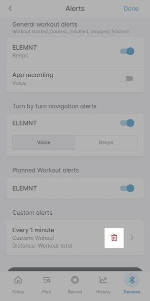

Delete an alert
  2. Select the deleteicon.png [Delete] button to the right of the alert you wish to edit.
  3. Select Done in the upper right hand corner.
wa-r3-alerts-edit-300.png wa-r3-customalerts-delete-300.png wa-r3-customalerts-delete2.png
