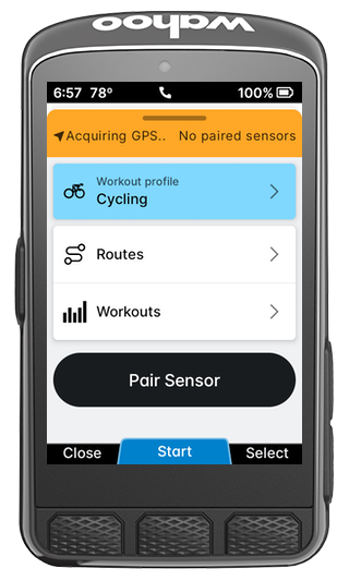

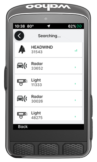

  1. Turn on or waken the radar unit.
  2. Add a new sensor from the from the Ready to Ride sensor tray or the Sensors page (accessed by tapping the power button once and swiping left).
  3. If the ACE does not prompt you to the radar, scroll down in the available sensors list. If there are a large number of sensors available, the sensor list will be divided by sensor type.  Radar units will appear under Other at the bottom of the list.

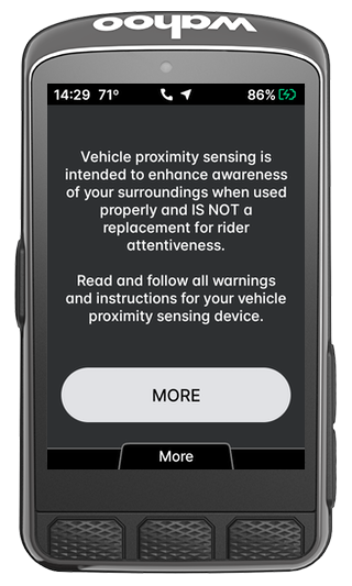

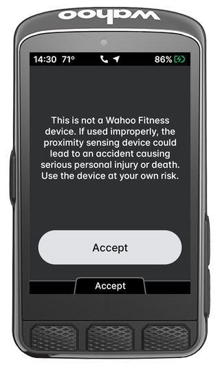

  4. Read and accept the safety warning statement.

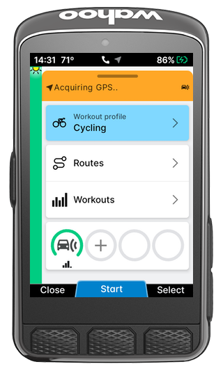

ace-r2r-nosensors-a320.png ace-sensors-radar-a320.png ace-radarpairing1-a320.png
ace-radarpairing2-a320.png ace-r2r-radar-a320.png txt3

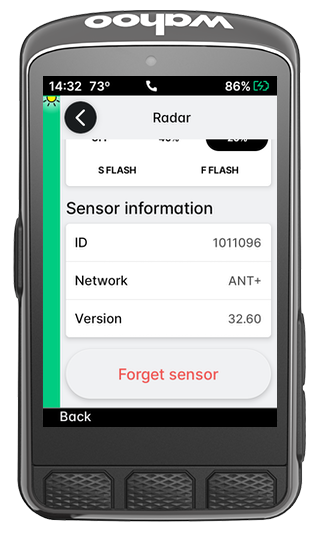

Radar Settings On ELEMNT ACE

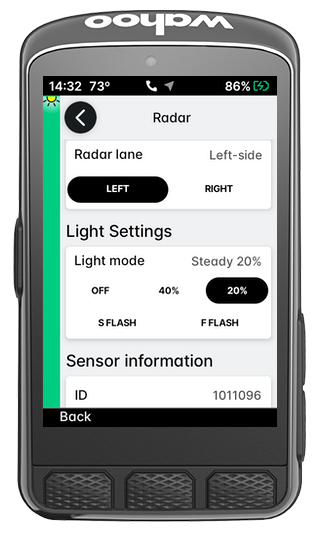

Once your ANT+ radar is paired, additional settings (including mute) may be accessed by selecting the sensor from the Ready to Ride sensor tray or the Sensors page accessed by tapping the power button once and swiping left.
ace-radardetails1-a320.png ace-radardetails2-a320.png ace-radardetails3-a320.png
Status
Shows as connected or not, and provides battery level.

Auto light
If enabled, (and the radar has a tail light) the light will flash asymmetrically when a car is approaching, and continue to do so for the period of time selected (1, 5, or 10 seconds) and then return to the selected light mode variety.  If disabled, the currently selected light mode will perform as defined by the light mode.
  • OFF - Light performs as selected
  • 1S - Light flashes as car is approaching + 1 second
  • 5S - Light flashes as car is approaching + 5 seconds
  • 10S - Light flashes as car is approaching + 10 seconds
Radar Lane
  • LEFT - Radar lane / car track appears on the left side of display
  • RIGHT - Radar lane / car track appears on the right side of display
Light Mode
Dependent upon the radar's available preset light settings.
