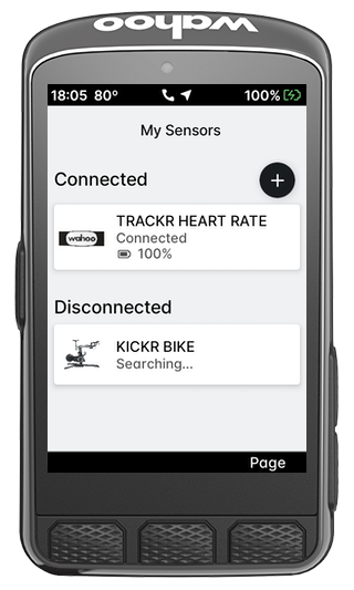

Sensors (page 2)
ace-mysensors-TRACKRHR-a320.png ace-trackrhrdetails-a320.png blank320x100.png
Add sensor (+)
  • Select the (+) button to have the ACE scan for available sensors transmitting data in the area.

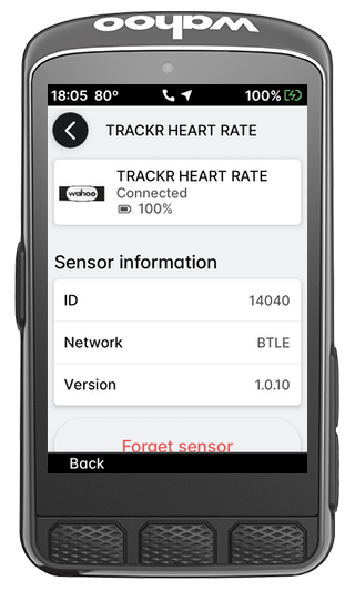

Connected
  • Any sensors that have been paired and are connected will appear here.
  • Sensor - when selected will open a page that shows:
    • Sensor name
    • Battery level
    • Any functional settings/actions that can be taken with the sensor
      • ex. SPEEDPLAY POWER, set crank length, auto-calibration, and manual calibration
    • Sensor ID
    • Sensor Network (connection type -- BTLE or ANT+)
    • Firmware version (if a Wahoo sensor)
    • Forget sensor
      • unpairs sensor from ACE
Disconnected
  • Any sensors that have been paired, but are not connected will appear here.
    • Sensor name
    • Sensor ID
    • Sensor Network
    • Forget sensor
