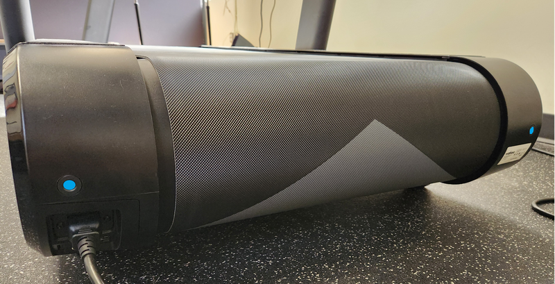

  3. Locate the small hole on that side on the front of the treadmill (either directly above where the power cord connects on one side or above the white model number sticker on the other). See image below.
  4. Insert a 6mm hex key into the hole / tensioning bolt, and turn clockwise 1/4 turn to move the belt away from that side of the treadmill, and back toward the center. (Note: it will do this by moving the side of the roller you are adjusting towards you)

  3. Locate the small holes on the front of the treadmill (directly above where the power cord connects on one side and above the white model number sticker on the other).
  4. Insert a 6mm hex key into the hole / tensioning bolt, and turn clockwise 1/4 turn to increase the tension. Repeat this for the other side.
