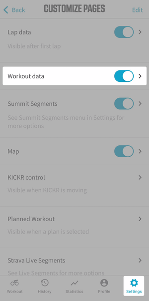

Access the page customization function
Navigate in the ELEMNT app to the Settings tab > CUSTOMIZE - Pages

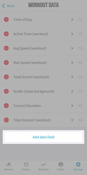

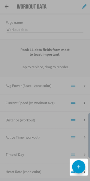

Add a data field
bica-customizepages.png bica-customizeworkoutdata-addfield-300.png baca-customizeworkoutdata-addfield-300.png
  1. Select the page you wish to customize.
  2. iOS - Scroll to the bottom of the page and select the Add data field button.
    1. Select the data type you wish to use.
    2. Select the data type you wish to use.
    3. The new data field you selected will appear. If the maximum data fields for that page were already present, one will be replaced.
  3. Android - Select the (+) [add] button

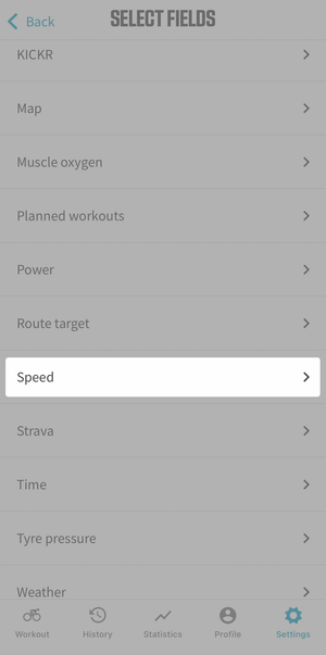

Change a data field
bica-customizepages.png bica-customizeworkoutdata-changedatatype-300.png bica-customizepages-selectdatatype-300.png
bica-customizepages-selectdatasubtype-300.png blank300x200.png blank300x200.png
  2. Select the data field you want to change.
  3. Select the data type you wish to use.

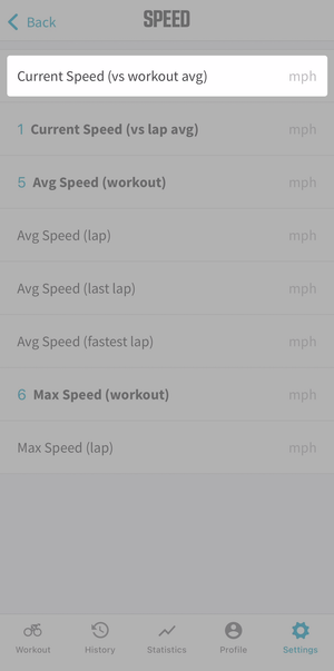

  4. Select the data sub-type you wish to use.
  5. The new data field you selected will appear in place of the previous one.

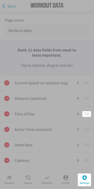

Move a data field
bica-customizepages.png bica-customizeworkoutdata-movefield-300.png blank300x200.png
  2. Press the three (iOS) or two (Android) horizontal lines  at the right edge of the line item for the data field you want to change and drag upward or downward to the relative position where you wish to move the field.

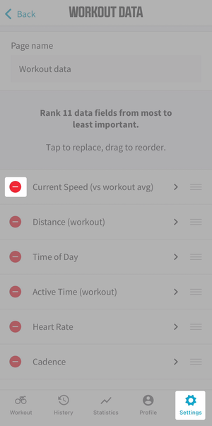

Remove a data field
bica-customizepages.png bica-customizeworkoutdata-deletefield-300.png baca-customizeworkoutdata-edit-300.png

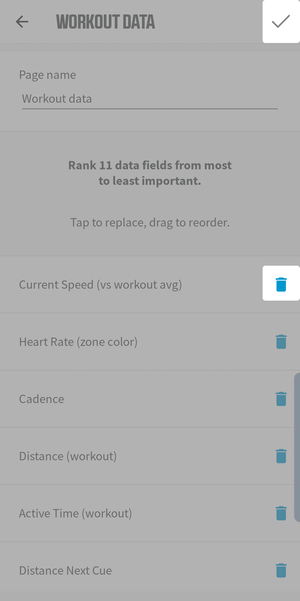

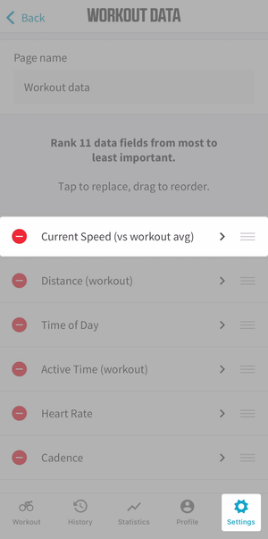

  2. iOS - Select the red delete icon to the left of the data field you want to remove.

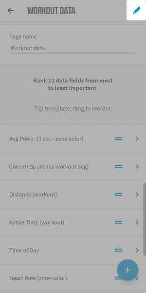

  3. Android - Select the editicon.png [edit] icon.
    1. Select the delete icon to the right of the data field you want to remove.
    2. Select the check button in the upper right corner to confirm.
