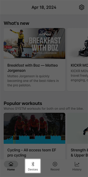

  2. Open the Wahoo app.
  3. Open the Devices tab.

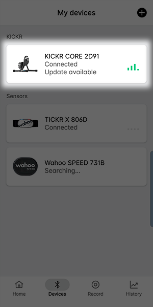

  4. Select your trainer or add it if you have yet to pair your trainer.  Upon establishing a connection with your KICKR, the Wahoo  app will determine if your trainer's firmware is out of date.  If an update is available, the app will display a notice - Update Available.
  5. Select Update firmware
