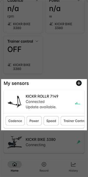

  1. Pair your KICKR ROLLR to the Wahoo app for iOS or Android like any other sensor, smart trainer, or smart bike.
  2. Once paired, select the ROLLR from the My sensors list in the Devices tab.

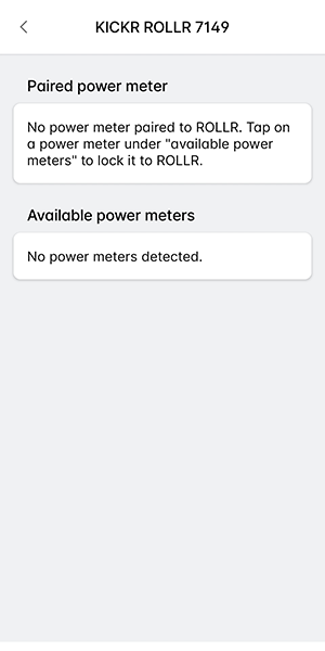

  3. If no power meter is paired, select No power meter.

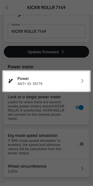

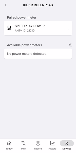

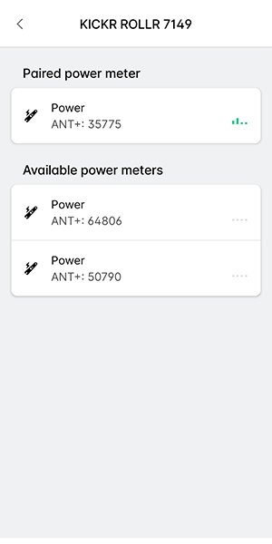

  5. Any ANT+/Bluetooth power meters broadcasting signal in the area will appear under Available power meters. SPEEDPLAY POWER pedals will be listed by name. All other ANT+ power meters will be identified by their 5 digit ANT+ ID, which is often found on the side of the power meter itself. Select your desired power meter.
  6. If a power meter is already paired, select the power meter under Paired power meter to de-select it.
    wa-rollr-powermeter-nopowermeter-300.png wa-rollr-powermeter-quarqpaired-300.png wa-rollr-spppaired-300.png
  7. Once selected, the power meter will appear under Paired power meter and will be automatically locked to the ROLLR.  It will remain locked unless replaced using the process above.
