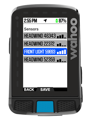

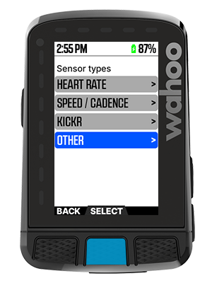

  3. Pair the smart light to the ELEMNT computer.
    • Navigate to the Menu page on the computer (tap the left side button).
    • Scroll down to the Sensors section.
    • Select Add new using the middle bottom button.
    • Select the light from the list of sensors that appear.
r2-lightsaddsensor-r300.png r2-lightaddsensormore-r300.png r2-lightaddsensorother-r300.png

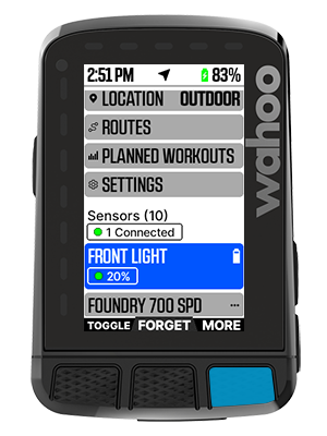

Change individual light settings
  1. Navigate to the Settings menu on the computer (tap the left side button).
  2. Scroll down to that light under Sensors.
  3. Select the light using the middle bottom button.
  4. Scroll down to Light Mode.
  5. Toggle between available light settings using the right front button.
  6. Return to Menu page using left front button.
NOTE: available light settings will vary by light based on presets offered by that light.

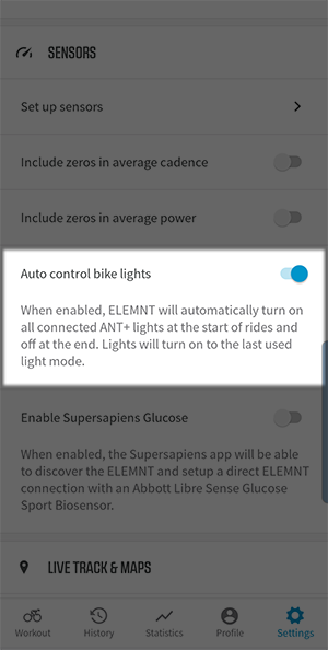

Set ELEMNT to auto-control bike lights
When toggled to ON in the ELEMNT app, the ELEMNT will turn the lights on to their last chosen setting when a ride is started, and off when a ride recording is ended.
  1. Navigate in the ELEMNT app to Settings > Sensors > Auto control bike lights.
  2. Toggle the feature on.
