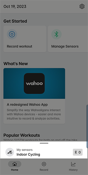

Sensor management [Wahoo app]
All sensor management has moved from the Settings page to a drawer accessed from the bottom of the Home page or the bluetooth button at the top of the Record page. Sensors can be added, will provide connection status and any data being transmitted here, and can be selected as the chosen data source from this page.
The sensor drawer has three components:
  1. The workout profile selector at the top indicates the current workout profile selected, and the profile to which the data type panels just below are mapped.
  2. The data source panels, which contain all of the possible data types for the selected workout profile.  Each panel contains [1] the data type label, [2] any data currently being transmitted to the app from a connected sensor of that type, and [3] the name and Bluetooth® ID of the sensor selected as the data source for that data type.
    If a compatible sensor is paired, connected, and selected, the name of the sensor selected for that data type will appear in the bottom of the panel, and any data of that type currently being transmitted by that sensor will appear in the middle of the panel. If no sensor is selected, no sensor name will be listed, and the data will show dashes -- .
  3. The My sensors list, which contain a list of all sensors you have paired to the app, regardless of which workout profile you currently have selected on panels. Each sensor panel will provide the sensor name and Bluetooth® ID, its connection status (Searching, Connecting, Connected, or Not found), and the sensor's selection status.  Any data types for which that sensor could be selected as a data source will appear in a box at the bottom of the panel.  If selected as the data source for a data type, that type will be highlighted in green, with a green dot beside it. If not actively selected, the box will be gray and without a dot.

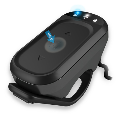

Set up a KICKR CLIMB
To set up a KICKR CLIMB with a compatible Wahoo trainer
    1. First ensure the KICKR CLIMB and smart trainer are plugged in and powered with the blue LED illuminated on the KICKR CLIMB remote.
    2. Press and hold the center lock mode button on the KICKR CLIMB remote for 3 seconds until the center white LED flashes steadily.
    3. Hold the CLIMB's remote near the KICKR or KICKR SNAP until the center white LED flashes quickly, then turns solid. The center white LED remains illuminated and solid while connected and successfully paired to the smart trainer.
Once the CLIMB is paired to the trainer, the CLIMB sensor details, bike wheelbase and tire circumference settings, tilt, and hub height status, and firmware update process are accessed from the trainer's sensor details page in the My sensors list.
sensors-connectedselected-core-crop-sm.png sensors-move-climb-crop-sm.png sensors-move-climb-sensorinfo-crop-sm.png
