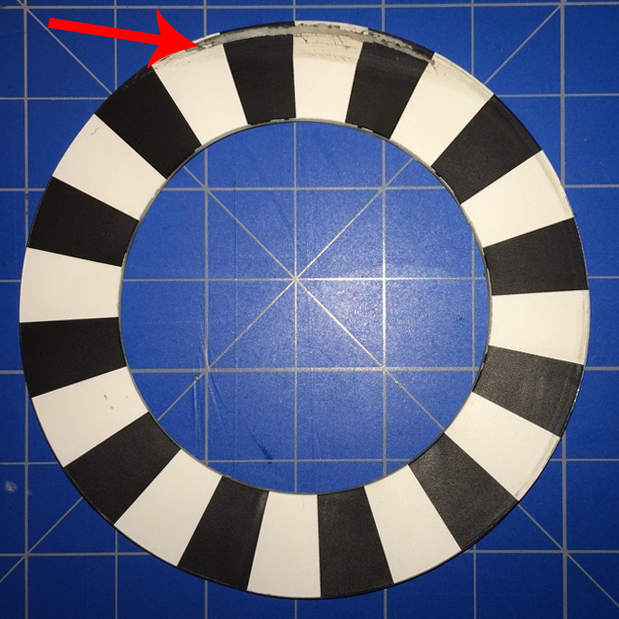

If the optical disc has scratches, specifically on the black sections, these can often be filled with a permanent marker or other darkening agent to restore functionality. Check this first, ensuring the disc rotates at least one full turn for thorough examination.
For reference, the following image is an example of a damaged optical disc:
