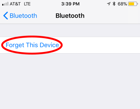

  3. Forget the sensor in the Bluetooth section.
    iOS Bluetooth settings with the info (i) icon circled next to a sensor under My Devices iOS Bluetooth device details with Forget This Device circled
