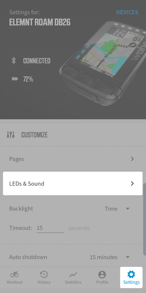

LEDs and sounds can be customized in the ELEMNT companion app Settings tab > LEDs & Sound as shown below.
